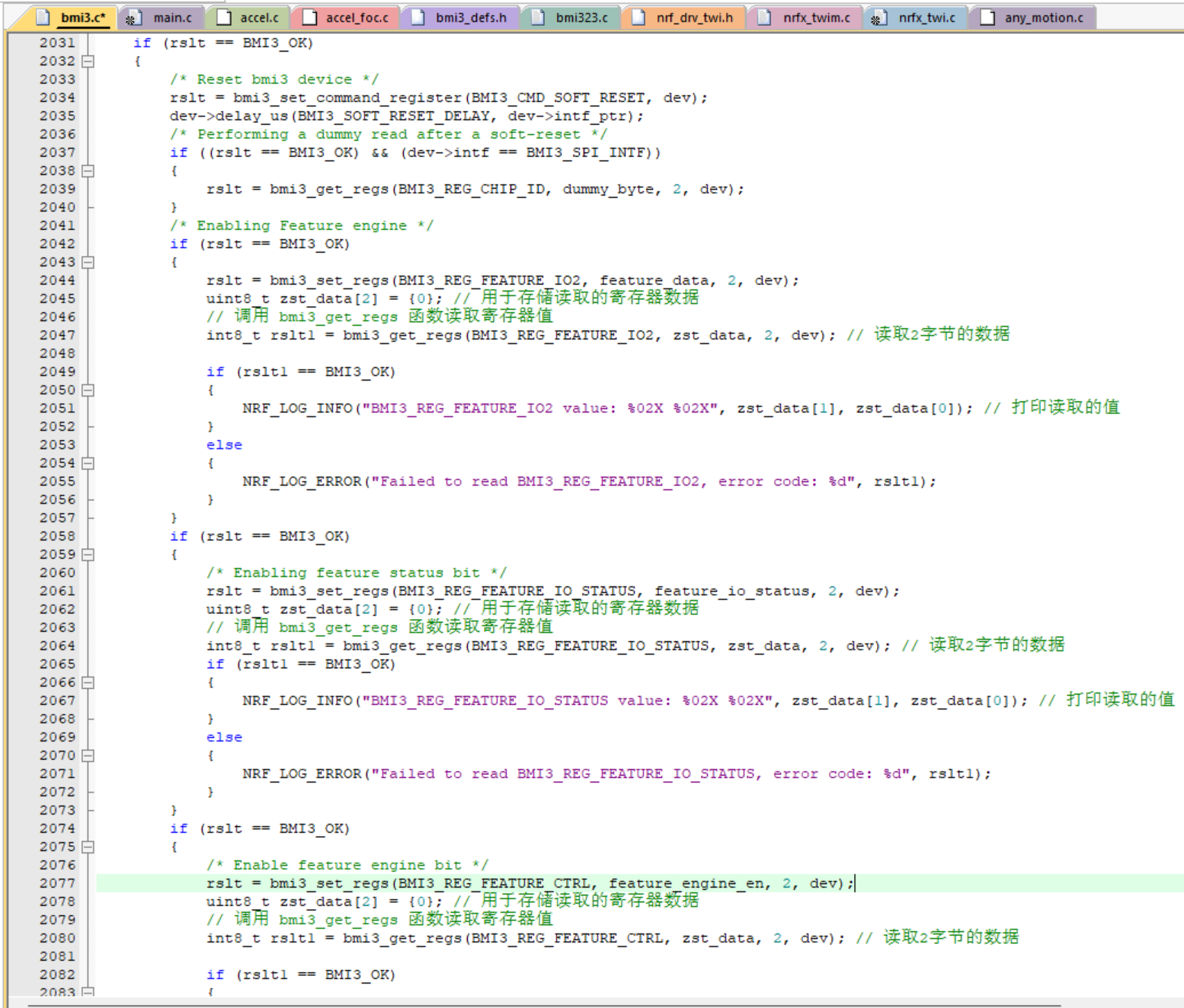

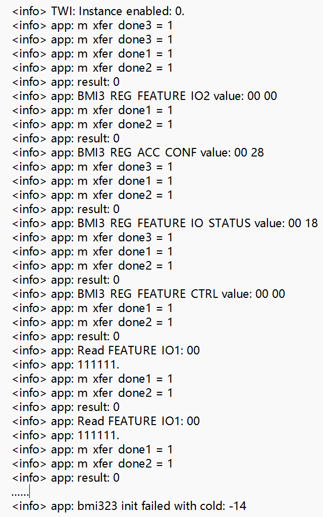

I am currently working on a project that requires connecting the BMI323 sensor to the nRF52832 via I2C. I adapted my code using the official example provided on GitHub (accel.c), but during the initialization process, the log repeatedly shows a **BMI3_E_FEATURE_ENGINE_STATUS** error.

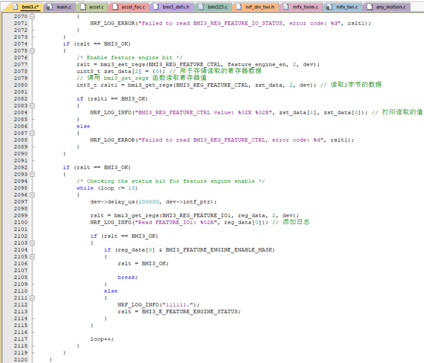

I traced the issue to the `bmi3_soft_reset` function, where the condition `reg_data[0] & BMI3_FEATURE_ENGINE_ENABLE_MASK` is consistently false. When I attempted to read the values of the registers **BMI3_REG_FEATURE_IO2**, **BMI3_REG_FEATURE_IO_STATUS**, and **BMI3_REG_FEATURE_CTRL**, I found that they remained at their default values, even though the function attempted to modify them in order to enable the feature engine. I suspect this is the root of the problem, but I don’t understand why these registers are not being rewritten. I attached the relevant Log information and core code of bmi3_soft_reset() function (appears in bmi3.c driver).
