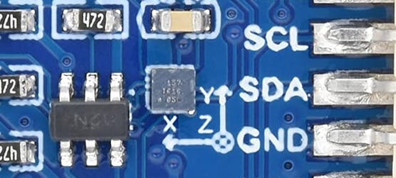

The chip is oriented so that the X-direction (as printed on the PCB) is pointing due North.
I do expect this to give a heading of 0 (zero) degrees, yet it is giving 86.3°, which I take as 90°.
