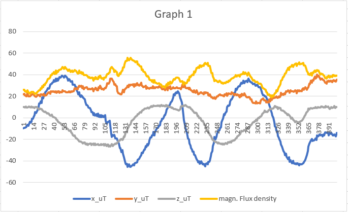

The problem is that when sensor is moved, the overall magnetic flux value (B = sqrt(x^2+y^2+z^2)) fluctuates (Graph 1).
There are no magnets around the BMM150. How this value can be trimmed? I've tried the compensation code from the
original API, but with no success, as the Y value showed the result in hendreds of uT.
What can be the reason of such results and where can I find the complete calibration process instructions?

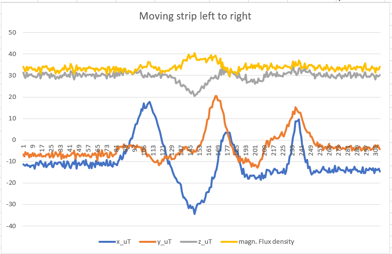

In addition, I've done some compensation by myself. Here is is:
*x = ((kXYRange/kMaxVal)*l_x + 6.18) * 1.07;
*y = ((kXYRange/kMaxVal)*l_y - 33.0) * 1.06;
*z = ((kZRange/kMaxVal)*l_z + 9.38) * 1.51;
After these modifications the graph of magnetic flux looks like in the pic. "Graph_2" (attached).
