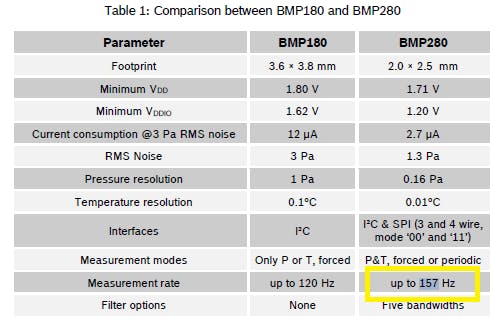

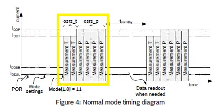

  1. What is the maximum measurement rate (157Hz VS. 166.67HJz)?
    However according to output data rate table it seems differently:

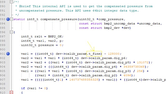

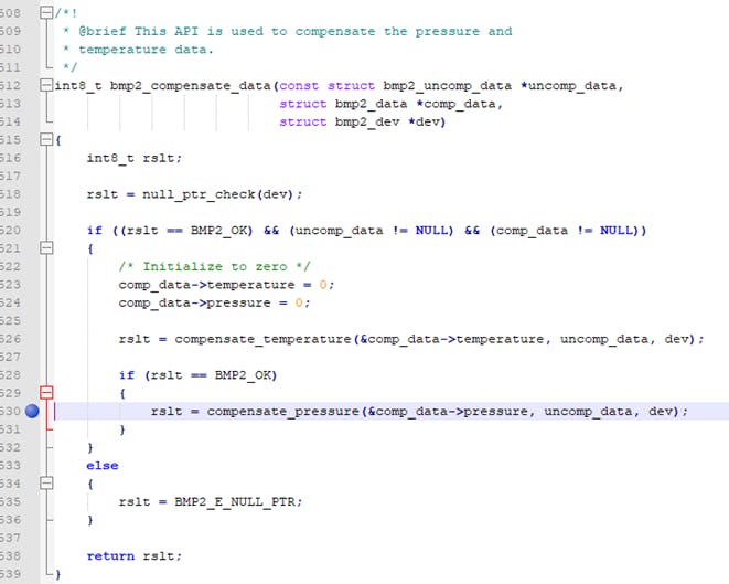

Moreover, at your reference code I’ve noticed that read pressure won’t be executed unless temperature has been read successfully before, pls see below snapshot:
also I can see that compensate pressure must have the fine resolution temperature value in advanced
