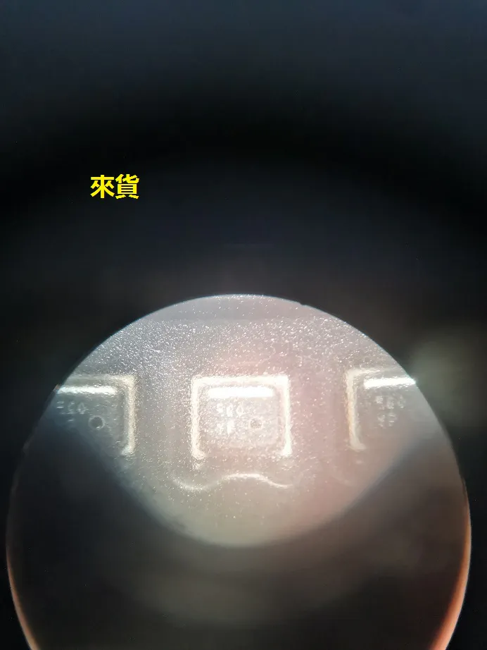

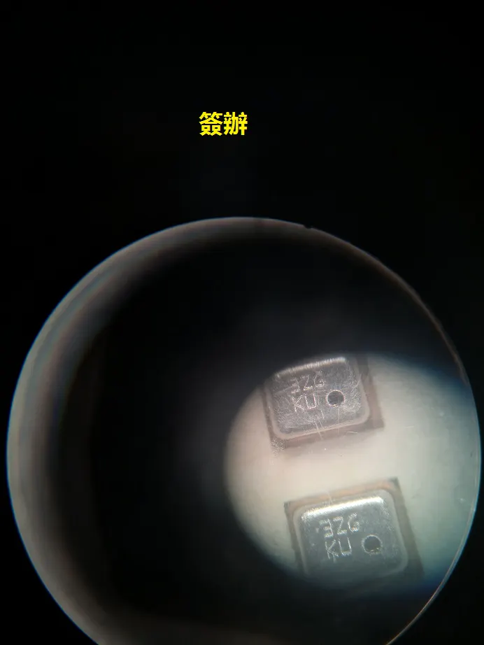

We have received some BMP280 and they look a little different from the parts from our previous batches. Specifically, the etching looks less clear and the hole on the top surface looks a little smaller. Is there any way we can prove that these are real/fake? Does Bosch have a lab in China that we can work with?
Current batch:
Previous batch:
Best reply by Vincent
The laser marking on the new parts in provided picture is not clear enough to identify the parts.  Normally, the lettler "K" in beginnin of second line is indicate it is BMP280.
In general, you can also read chip_id to see if it is our parts.
We have local FAE in Shanghai, Beijing and Shenzhen where you can contact to ask for testing and identify the samples you had.
