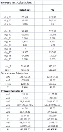

Below are the Bosch worked example (“Datasheet” heading) and the results from my module (“PIC”) compared using the terminology in the Bosch datasheet. My test was performed at sea level and the temperature was 24.4 Celsius (measured with a thermometer accurate to 0.5 Celsius).
The calculated temperature appears to be accurate, but the calculated pressure is very wrong.
There is generally good agreement between the compensation parameters (dig_T1 through dig_P9). The exceptions are the values of dig_P4 and dig_P5. The values of adc_P also differ to some extent. Going through the maths provided in the datasheet, it seems that these are the parameters that cause the pressure result to be low. BTW the pressure reading does vary if I change the ambient pressure, but the reading is always low.
Can anyone suggest a way forward for me? Is it possible that some of the compensation parameters are wrong? Would a faulty pressure sensor be a likely cause? Any thoughts gratefully accepted.
