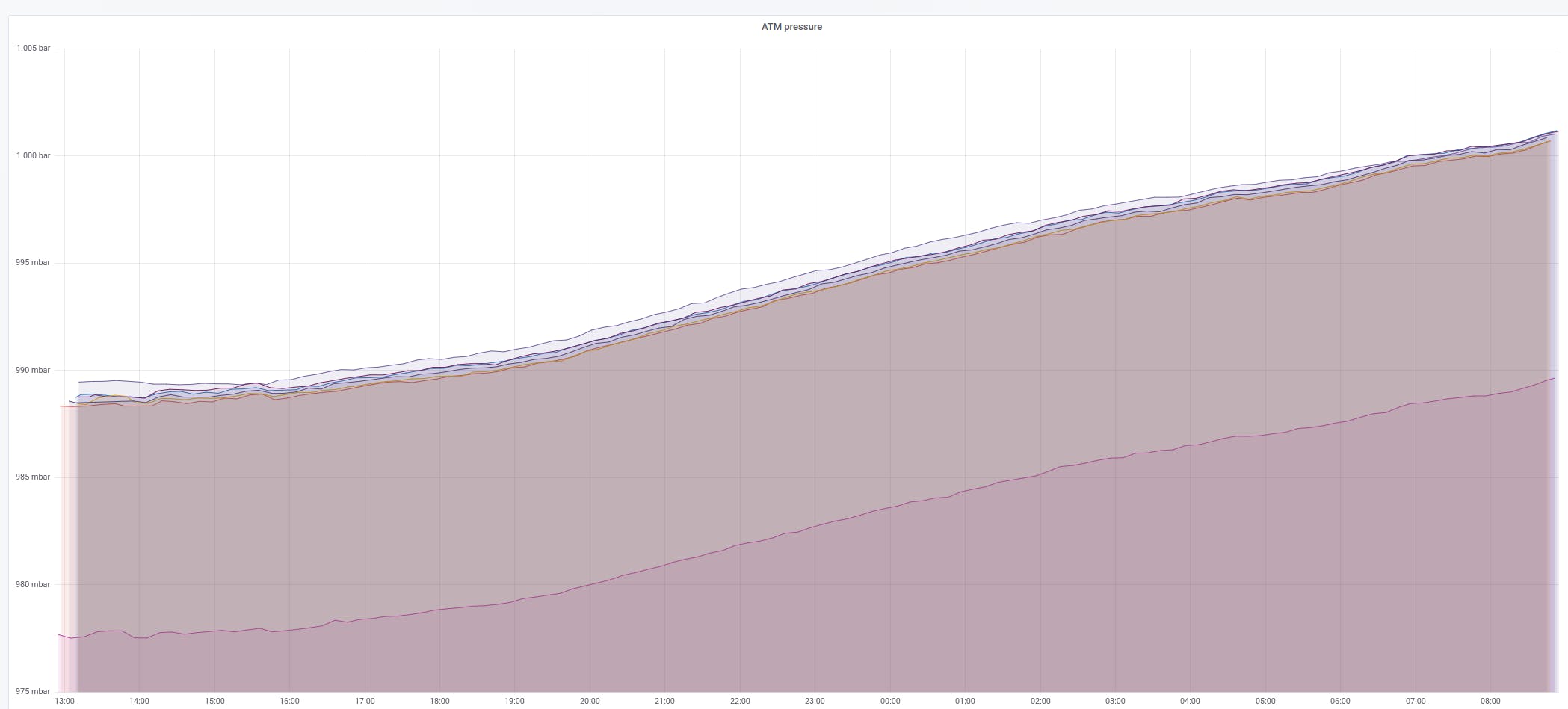

I just received a a patch of custom PCBs with BMP280 in them. 1 out of the 5 boards I have tested so far is giving wrong pressure values. I am using drivers from zephyr project and using I2C communication. It looks like the sensor follows the same curve as the other ones, but it just reports ~10hPa too low values
