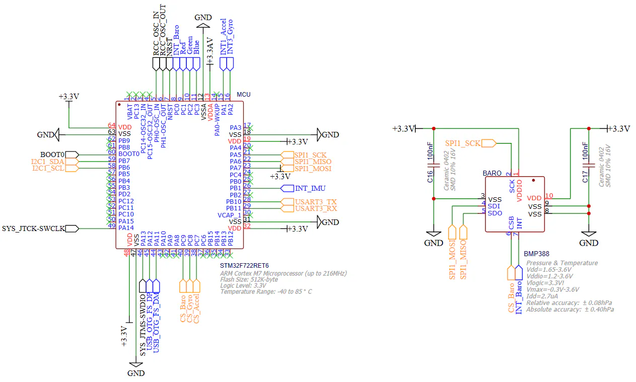

I have a PCB with the BMP388 and I am trying to communicate with the sensor from an STM32F722 via SPI.
This is the schematic:

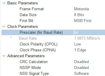

This is the SPI configuration in STM32CubeIDE:
When trying to communicate with the sensor via SPI, I receive the wrong chip id (0x22 and 0x0F, depending on the SPI configuration).
Also, the sensor never enters normal mode and the data ready interrupt never fires.
