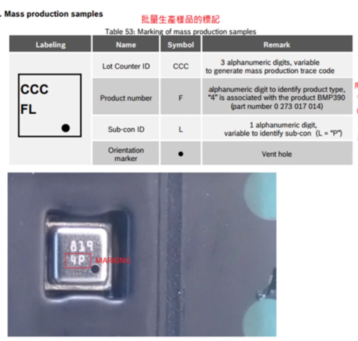

We have a component labeled as Bosch BMP390 with Date Code: 2417.

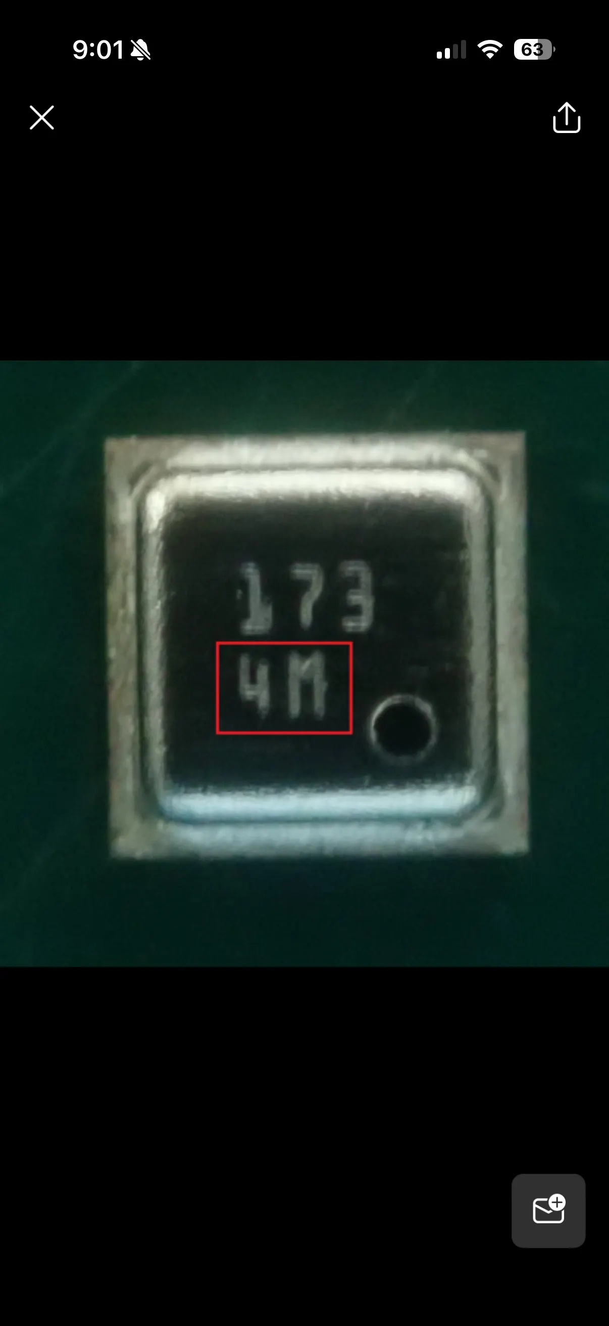

The marking on the actual part, as shown in the attached image, displays "4M" in the second line (highlighted in red), which differs from the "P" indicated in the datasheet.
Could you please explain the reason for this discrepancy?
Is there any official documentation that can clarify or confirm this?
