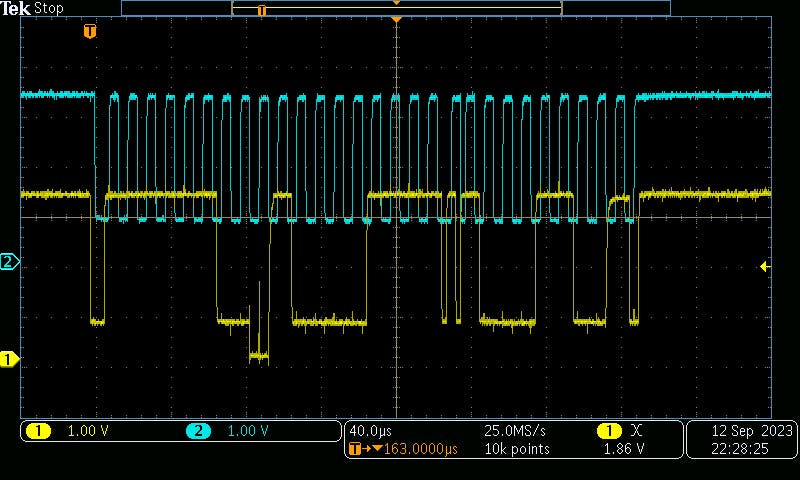

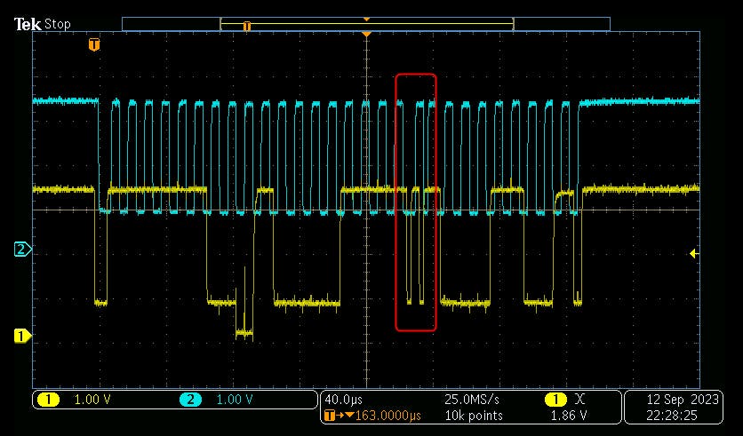

Attached is the screenshot for sending a SETDASA command.
It returned NACK for static address.

Hi choongay,
The waveform of your host's I3C does not meet the I3C specification. We suggest that you refer to the I3C specification to communicate with BMP581.
