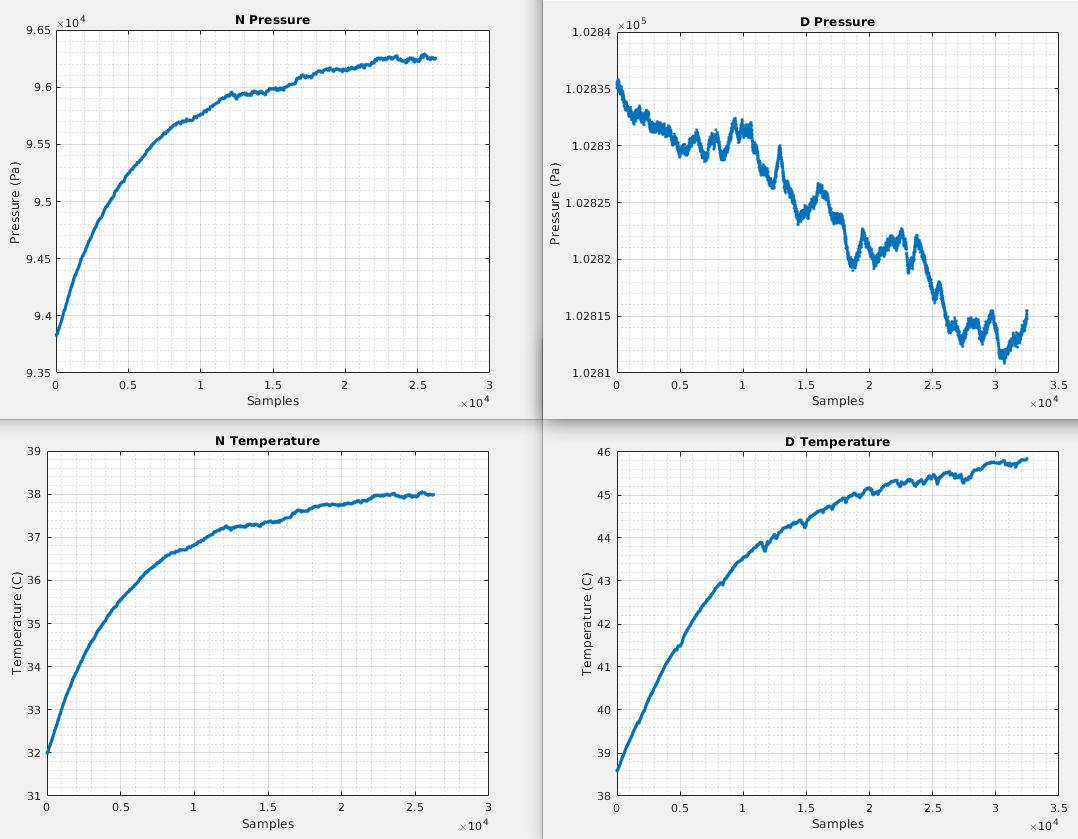

I've got two BMP581 sensors. One reports the correct pressure (see right hand plots), the other does not and has a strong correlation with temperature (see left hand plots).
Is there any way to debug the temperature compensation parameters?
The datasheet describes checking the NVM CRC but I can't read the NVM memory using the functions in https://github.com/boschsensortec/BMP5_SensorAPI
Thanks for any help you can provide!
