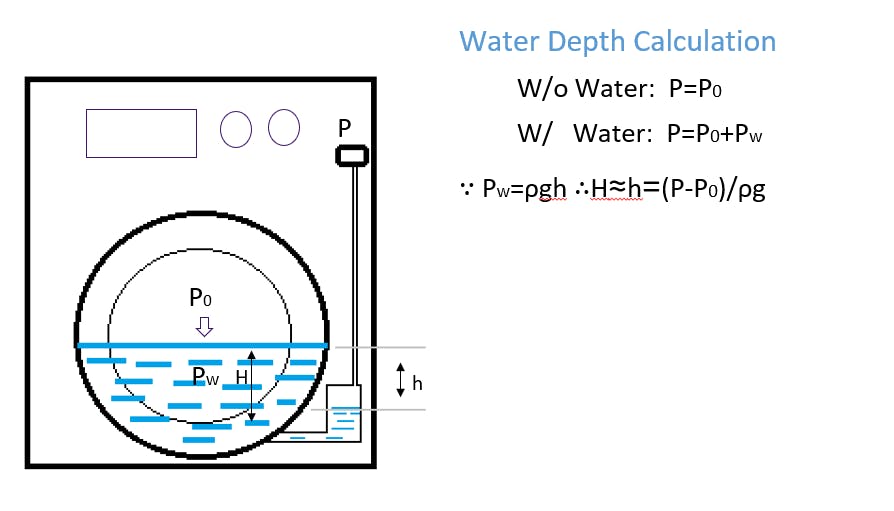

I want to measure the water level with bmp581.
So, how does this sensor track water levels with mm precision?
Bosch Video (84) Detecting the water level of a washing machine powered by BMP390 - seems to be suggested by YouTube.
Is there any example code or guide document I can refer to?
