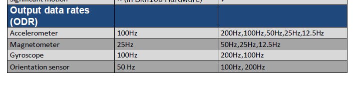

1) Refering to the Table on page 7 of the guide (screen capture below) about the ODR settings, I am assume this is specifying the required configuration settings for each of the 3 sensors. Is that correct?
2) I am really unclear about how often I need to feed the library data via the bsx_dostep call. Do I need to feed it at the ODR rate? That is, should I be calling this function at a rate of 100Hz to supply it the accelerometer and gyroscopic sensor?

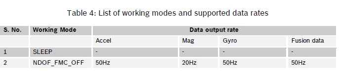

3) Table 4 on page 14 shows a list of support data rates (screen capture below). What does Output data rate actually mean in this context?
