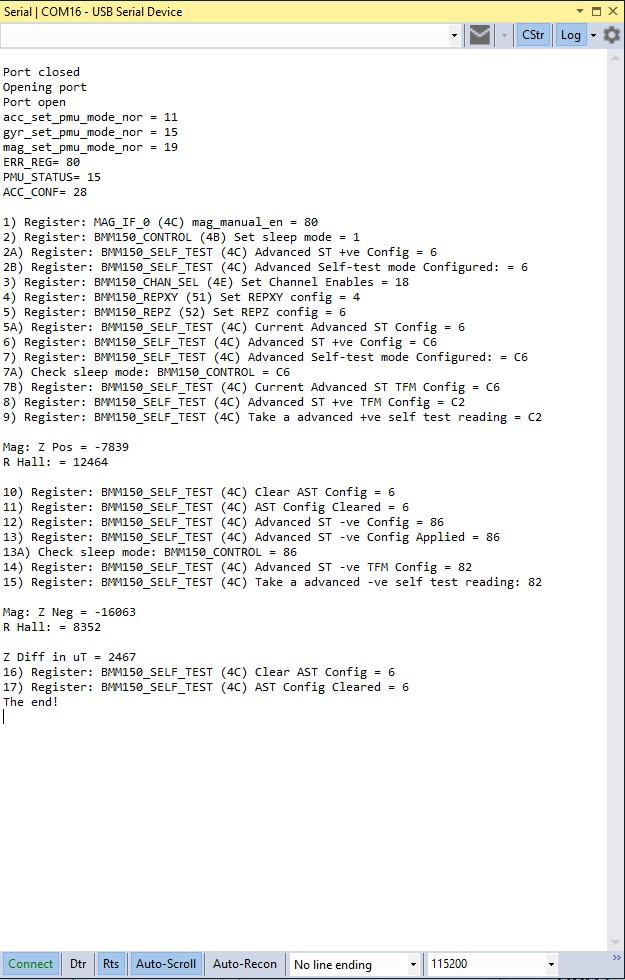

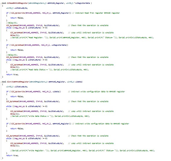

  1. BMX160 Indirect Read-Write Code V01 -the Arduino cpp code snip that is used to read and write to the BMX160 over I2C. In my code I test the BMX160 status register to make sure the transaction is complete but it doesn't always work. Sometimes the data returned from the current read is the data from the last read. See the BMX160 Advanced Test Configuration the sequence.
  2. BMX160 Advanced Test Configuration V01 - the prinout of the steps to perform an Advanced Self Test and the results look odd. I have assumed that each bit in the count is 0.3uT although it is difficult to work out what is going on in the BMM150 code as it includes compensation using Trim data.
