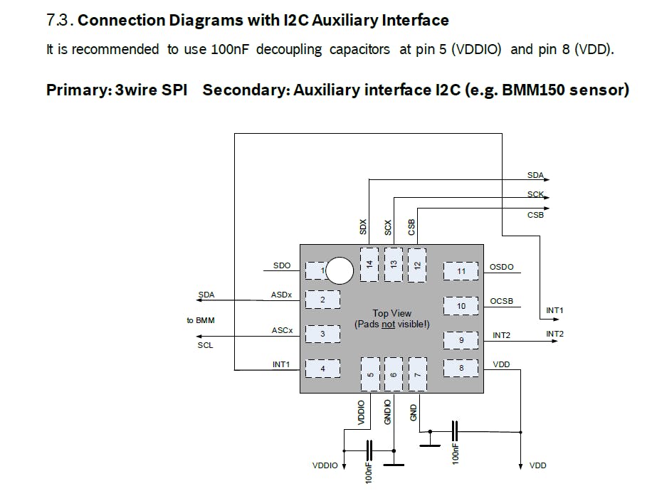

I'm currently using BMX160 for my project. However, it is out of stock everywhere i seached for.
Is there any potential replacement? My piority is having same footprint and similar performance
Thank you in advance.

Hello t_an0410,
The recommended solution is to use BMI160 or BMI270 and external BMM150. Both BMI160 and BMI270 have a second interface, which can extend BMM150.
