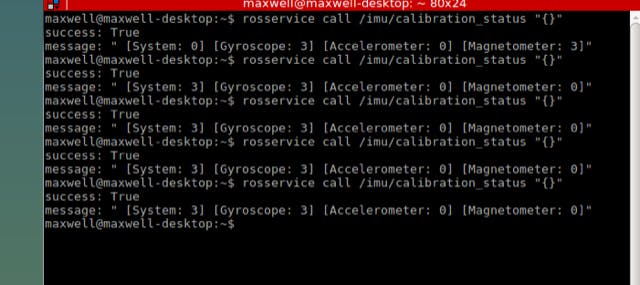

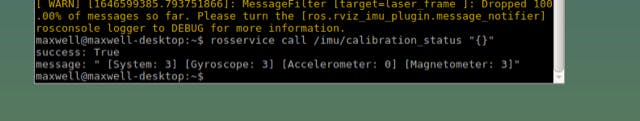

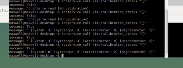

During todays work when I look to check the calibration I get anything except 3,3,3,3
there are some examples of the BNO055 loosing its calibration. I check it because the behaviour of the sensor is not exactly consistent

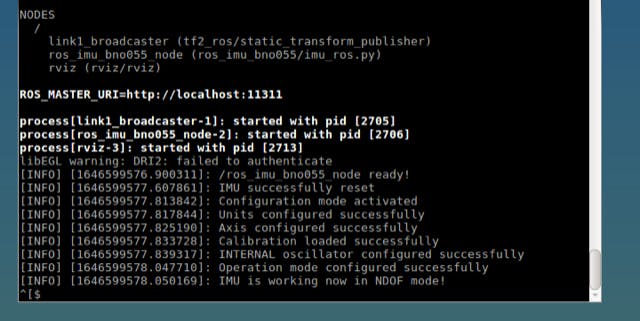

when I start the bno055 I get this output
Everything looks good.
