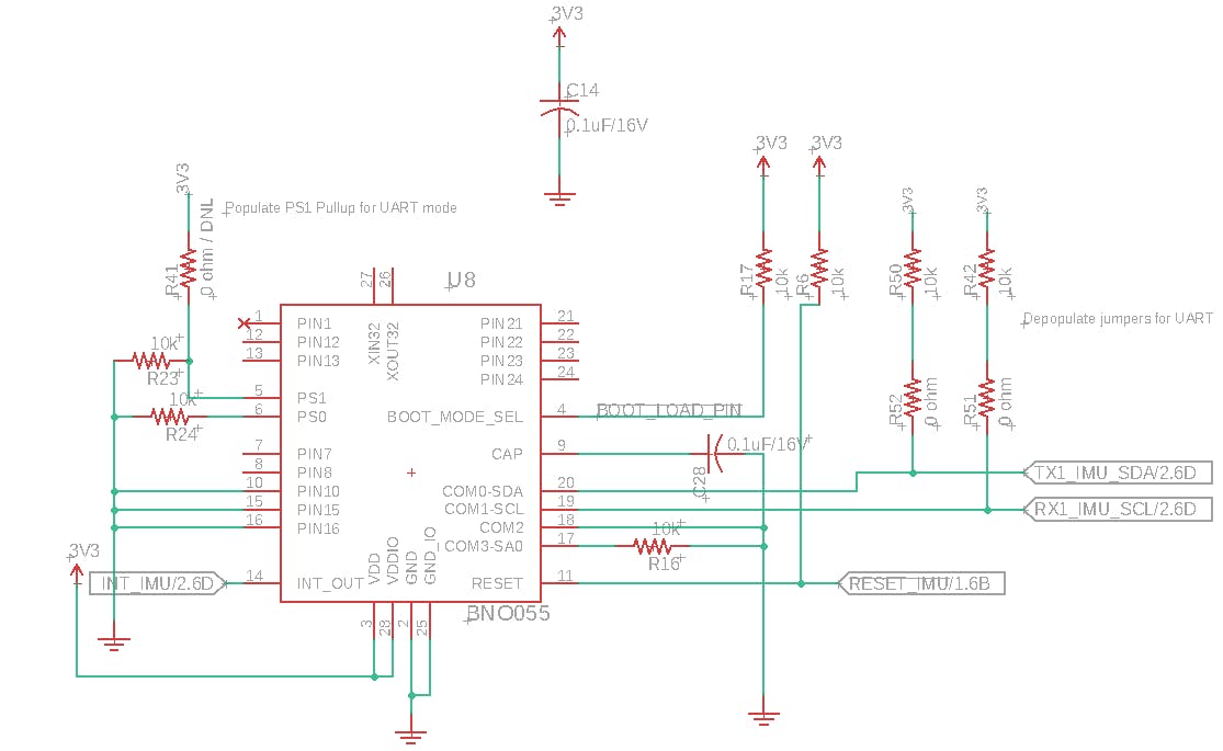

1. half our BNO055 fail to communincate AFTER we successfully read any data from the BNO055 and then do a reset using the nReset pin (low, wait 100 ms, then high, wait 1000 ms)

See schematic:
Note: We were told that the issue could be PS0 and PS1 being pulled up / down with resistors but we just made those 0 ohm jumpers on the bad boards and still see the issue
