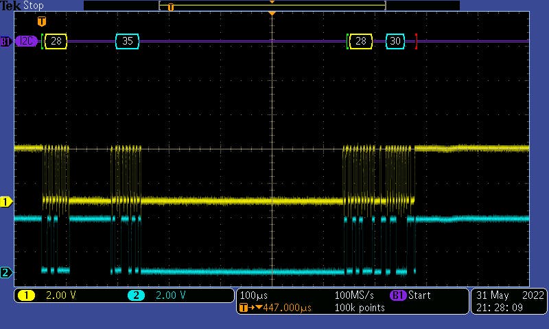

I find that the BNO055 induces quite long I2C clock stretching. The BNO055 is running in normal power mode and DNOF mode. Below is the CALIB STATUS read once every 1.2 seconds. There is no other I2C traffic.

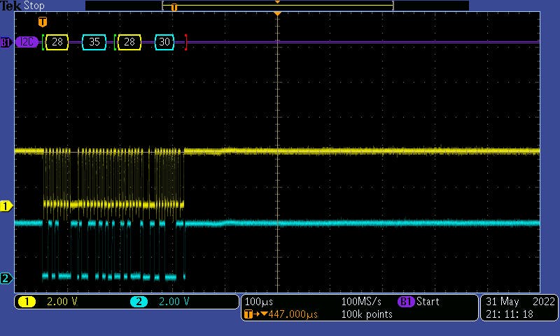

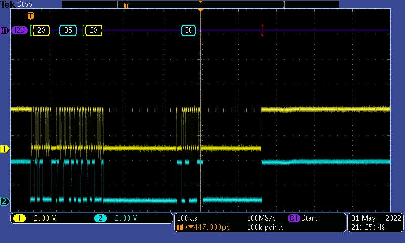

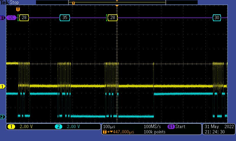

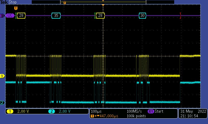

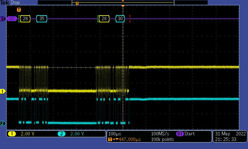

Below are some scope traces; These were all taken during the same test. It randomly occurs
Is this expected behaviour, or do I have an problem?
