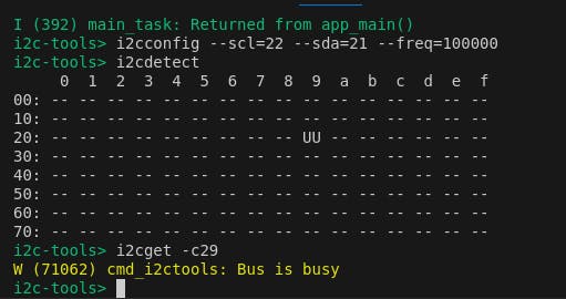

For days, I have had a problem initializing the BNO055 IMU sensor with the ESP32. After troubleshooting , here is the output of i2c tool? This always causes a blockage in reading and writing to the sensor.
Note that I am using esp-idf, and when i tried the same hardware with Arduino IDE, it worked perfectly.

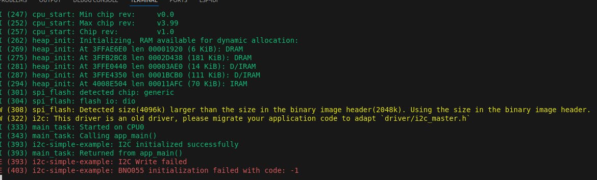

And this is the output:
Any help or comment would be appreciated.
