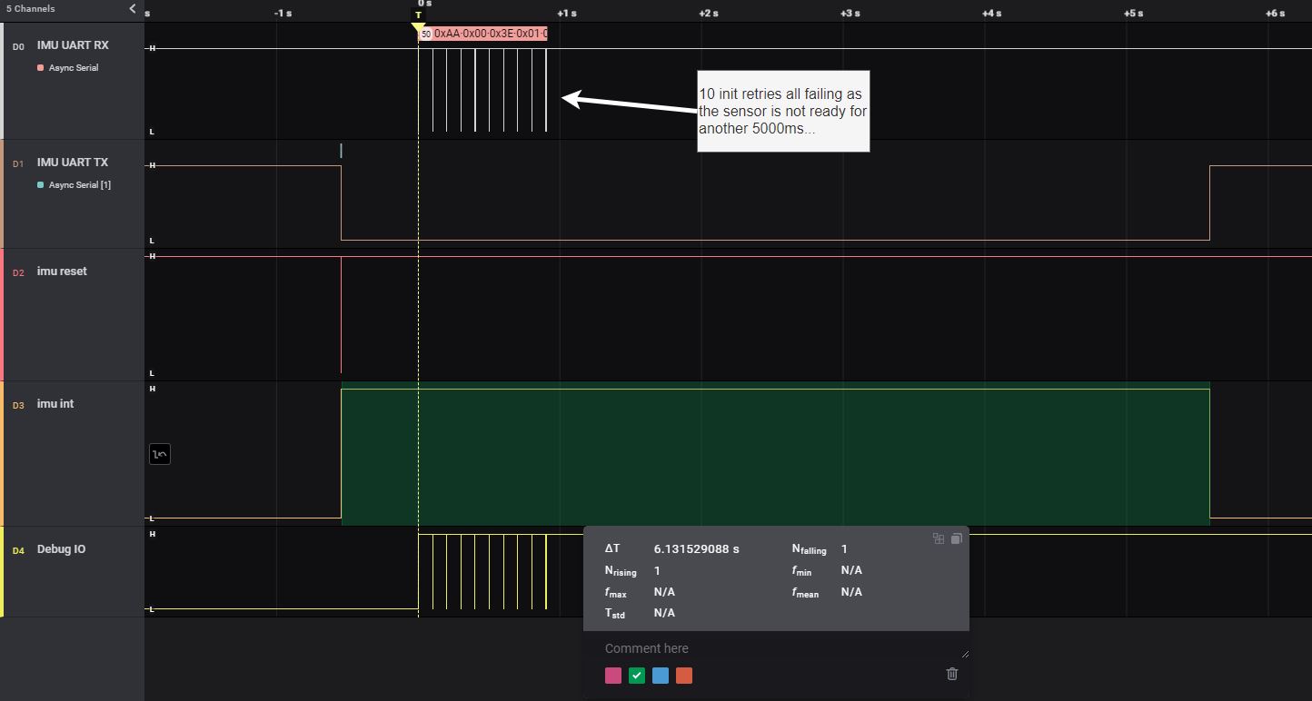

However - occasionally the interrupt pin seems to stay high for an unusually long time - in the case below it is more than 6 seconds (compared to a usual 500ms).
What we do when the sensor is not responding correctly, we wait a bit and try again. This happens 10 times and then we report an error. In this case, it works normally after these 6 seconds - but we cannot design our product expecting a 6 second wait to initialize this sensor.

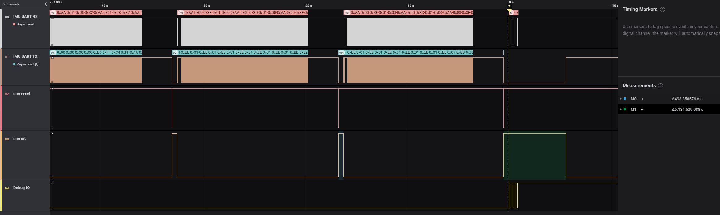

I attached a scope capture where the device is repeatedly rebooted thus resetting and initializing the BNO055 until the problem appears. Until the problem appears, everything seems to be working as expected and nothing unusual is happening before the interrupt pin stays high for this (relatively) large amount of time.
