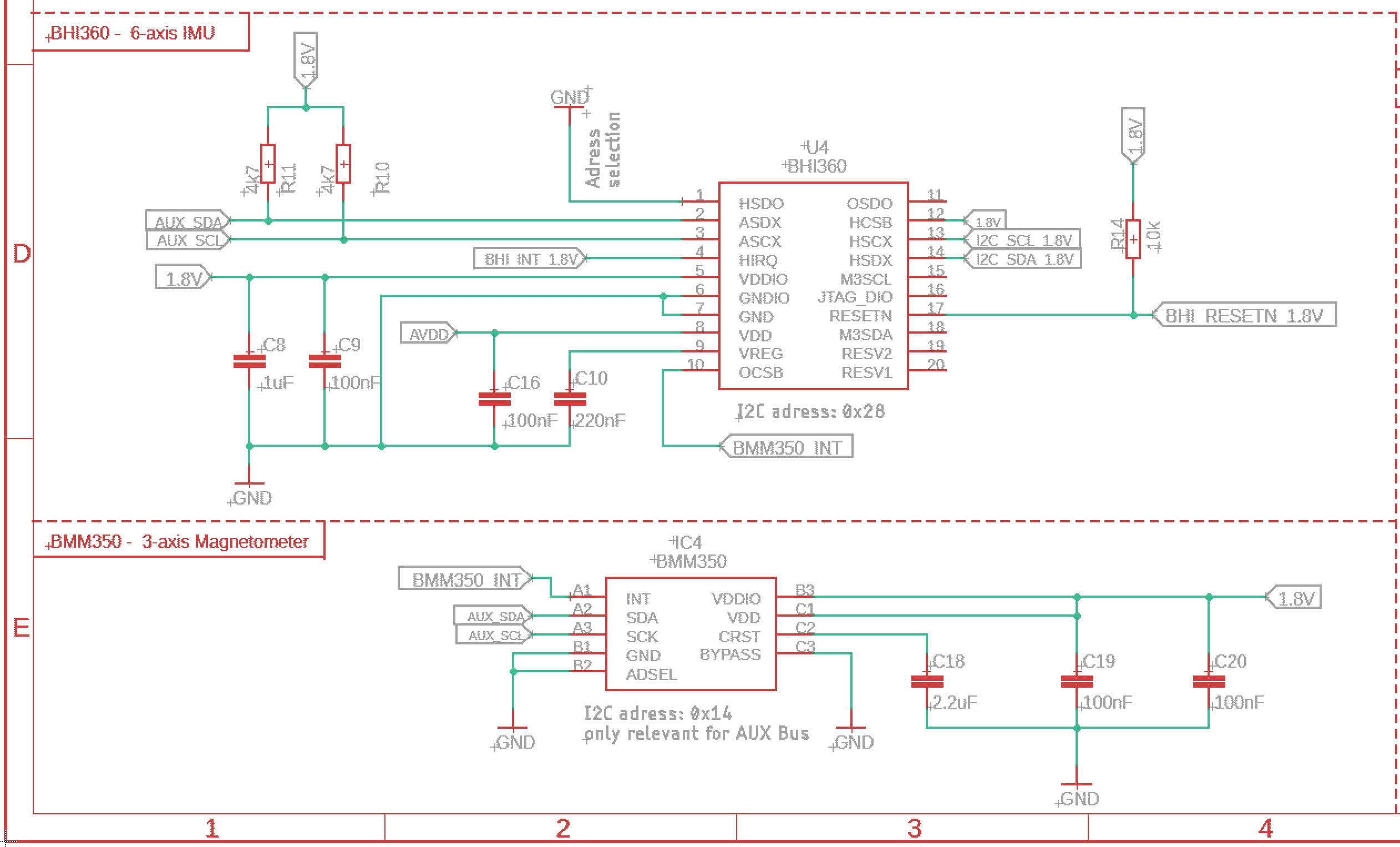

Hello, for a project, I designed a PCB incorporating multiple sensors, including the Bosch BHI360 and BMM350.The schematics for these two sensors are provided below.

I have already tried different firmware images and examples.
