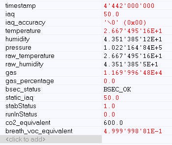

I think I have successfully import the BSEC library and now can get the data from I2C bus.
Since I got the output value, but I am not sure if this is correct, so need your help to confirm.
another question is how can I calculate the ethanol? not clear after reading the datasheet(especially Table 5).

and here is the output value in output_ready().
Hi chakey,
BME680 is a metal-oxide based chemical sensor. The sensor output is created by interaction of volatile organic compounds (VOCs) with the sensitive layer of BME680. Unlike a physical sensor (e.g. pressure sensor like BMP), chemical sensors are thus influenced by a plethora of parameters and their response is very complex. On the one hand, this implies that quantification of VOCs is not possible in a random VOC mixture like the one the sensor faces in a real world environment.
Take LP mode as an example:
The IAQ value obtained within 8 hours is not credible, and it can be obtained after more than 8 hours.
After 7 days, the output value of different sensors under the same environment should be within the scope of the specification, ± 15+± 15%.
