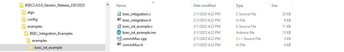

Hi rezza,
bsec.cpp was not contained in BSEC2.4.0.0. As you downloaed BSEC2.4.0.0, please use the example code under BSEC2.4.0.0 package.
