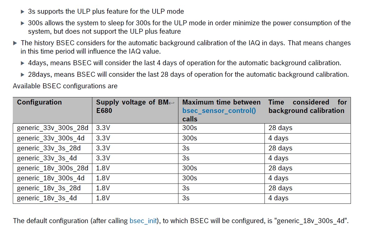

You could config the interval to 300 second according BSEC integration guide.
