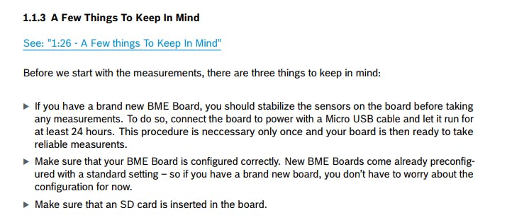

Hello everybody - does anyone know what to do after a firmware-update on the Shutelboard / Development Kit / flashing the COM-Port??!! Is it again like a new system and - do I have to burn in again the 8 sensors for 24H?! ..
Complete BME688 Development Kit (ready-to-use) / burn in again for 24H after firmware-update?!
Hi KK32l,
If you would like to record BME688 sensor data with dev kit, you should refer to the following two steps:
Step 1: refer to the document https://www.bosch-sensortec.com/media/boschsensortec/downloads/product_flyer/bst-bme688-fl001.pdf to upgrade latest BME688 dev kit software.
Step 2: refer to the application note https://www.bosch-sensortec.com/media/boschsensortec/downloads/application_notes_1/bst-bme688-an001.pdf to start your use of BME688 dev kit & BME AI-Studio.
