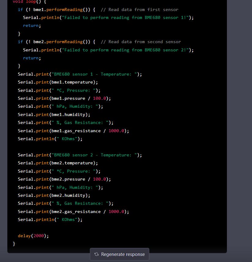

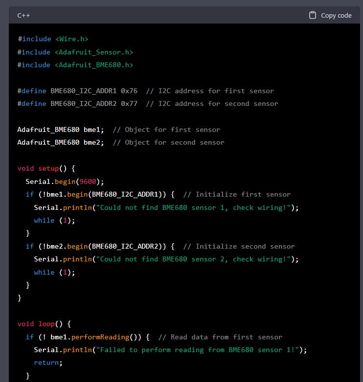

"I followed step 1 to 5, but i can't find the part of the code where i need to change 0x76 to 0x77. Can you show me a code example where this is located. "
This is the code that chat GPT gave me and it worked perfectly for me I had change nothing.
CONCLUSION:
This code solved my problems and worked perfectly with the following cables connected for both sensors:
-Connect the VCC pin of each sensor to the 3.3V pin of the Arduino, GND pin to GND, SDA pin to A4, and SCL pin to A5
And the following connection wich is different for both sensors:
-To differentiate between the two sensors, connect the SDO pin of one sensor to GND and the SDO pin of the other sensor to the 3.3V
