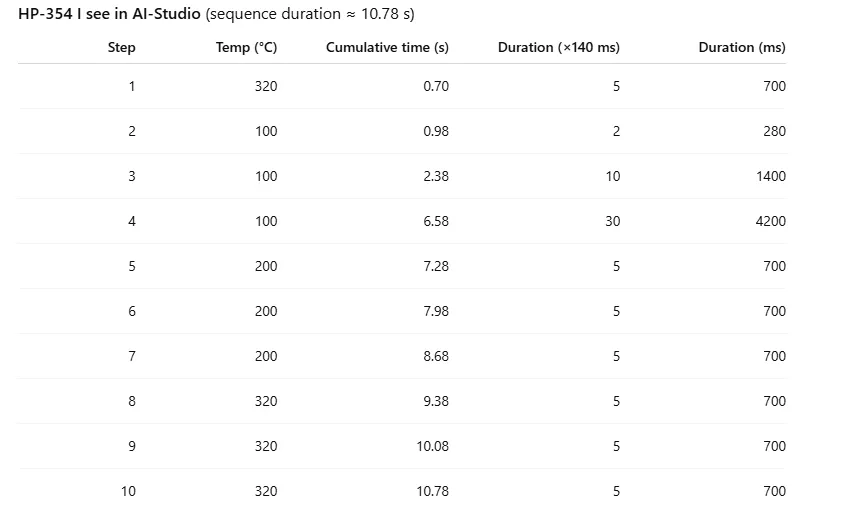

    So, temps:
    {320, 100, 100, 100, 200, 200, 200, 320, 320, 320}
    durations (ms):
    {700, 280, 1400, 4200, 700, 700, 700, 700, 700, 700}
    (I also saw forum snippets stating the duration unit is 140 ms — please confirm this is correct for HP-354.)

    What I plan to implement (pseudo-C):
    static const uint16_t HP354_TEMP_C[] = {320,100,100,100,200,200,200,320,320,320};
    static const uint16_t HP354_DUR_MS[] = {700,280,1400,4200,700,700,700,700,700,700};
    static const uint8_t HP354_STEPS = 10;
    // bme68x_set_heatr_conf(BME68X_PARALLEL_MODE, ...) with the arrays above,
    // then bme68x_get_data() to read per-step fields and log them (gas_ohm, T, RH, p).
Any official recommendations or example mappings (HP-354 ↔ BSEC2 config blob) would be super helpful.
