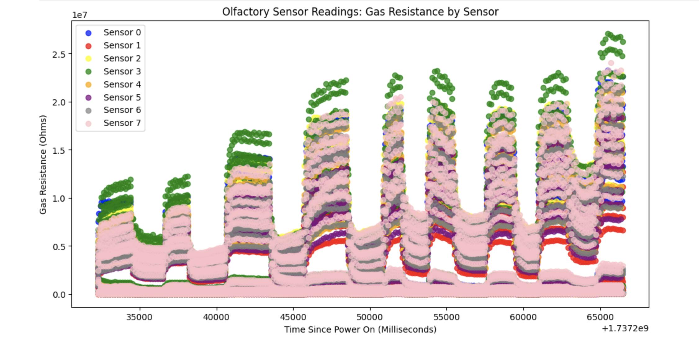

I then attempted to graph that data using Matplotlib in Python, but I noticed that the data was very inconsistent and noisy. I am aiming to train my own machine learning learning algorithms, with custom parameters that BME Ai Studio does offer. I have attached a picture of my graphed data below, and as you can see, there is a wide range of gas resistances for each samples. I don't think that the data can be used properly to train the algorithms like I am looking to do.

Any help or information about this would be much appreciated. As I mentioned before, I have attached an image of the raw data that I graphed myself, with no preprocessing done. If it is possible to just train the algorithm with that data itself, please let me know, but I am not sure about that. Thank you for the advice.
By the way, if you are wondering about the order of the recording, it was done like so:
Normal air, sample 1, normal air, sample 1 variant, normal air, sample 2, normal air, sample 2 variant, normal air, sample 3, normal air, sample 3 variant, normal air, sample 4, normal air, sample 4 variant, normal air. But you can see that the gas resistance fro normal air drifts significantly, and this was something that was not seen in BME Ai Studio, which is what leads to me to wonder if there are any preprocessing steps being done, or library functions being used?
