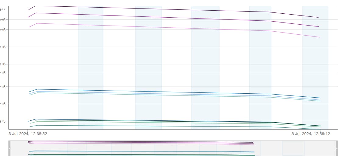

Gas Resistance data looks different in BME AI-Studio Desktop from BME AI-Studio Mobile App
Hello! I am currently trying to collect some ethanol vs ambient air data. When I am collecting the data using the app, I can see clear peaks of when I expose the sensor to ethanol vs when I leave it lying in ambient air. However when I try to import this data to the desktop application, the data looks completely different and contains no peaks. I would like to be able to see these peaks so I can clean and clearly label the start and end times of my ethanol samples.
Mobile App:
Desktop App:
Is there a way to fix this so that the data on my desktop looks the same as the data in the app? Or at least a way to see the peaks more prominently? I am also not able to zoom in on the desktop for some reason.
