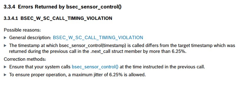

I viewed bst bme integration guide found this: but I do not know how to fix this:
Hi Mark-Walen,
Return value 100(BSEC_W_SC_CALL_TIMING_VIOLATION) means "Difference between actual and defined sampling intervals of bsec_sensor_control() greater than allowed", you need to strictly refer to previous example code.
