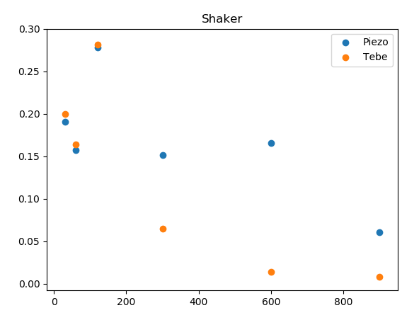

I found a lot of accelerometer that meet the specifications above, although I am not being able to understand how can I guarantee a good resolution in high frequencies of the accelerometer.
I already tested the MPU9250 in a shaker and the results in low frequency (until 150Hz) is reasonable, although in high frequencies (from 150Hz until 1kHz) it is horrible as shown below:
ps- the blue dots are the reference accelerometer (piezoeletric) and the orange dot is the MPU9250.
My question is:
  • How can I understand from the datasheet that the resolution in high frequency will be ok?
