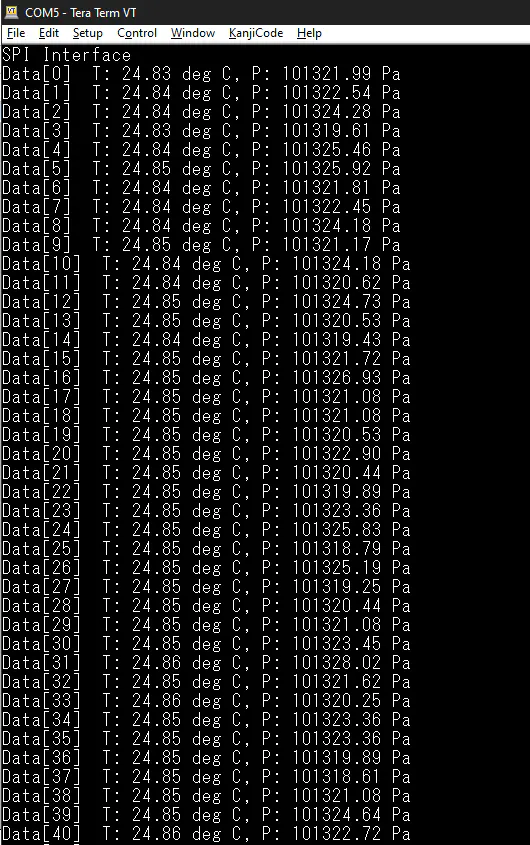

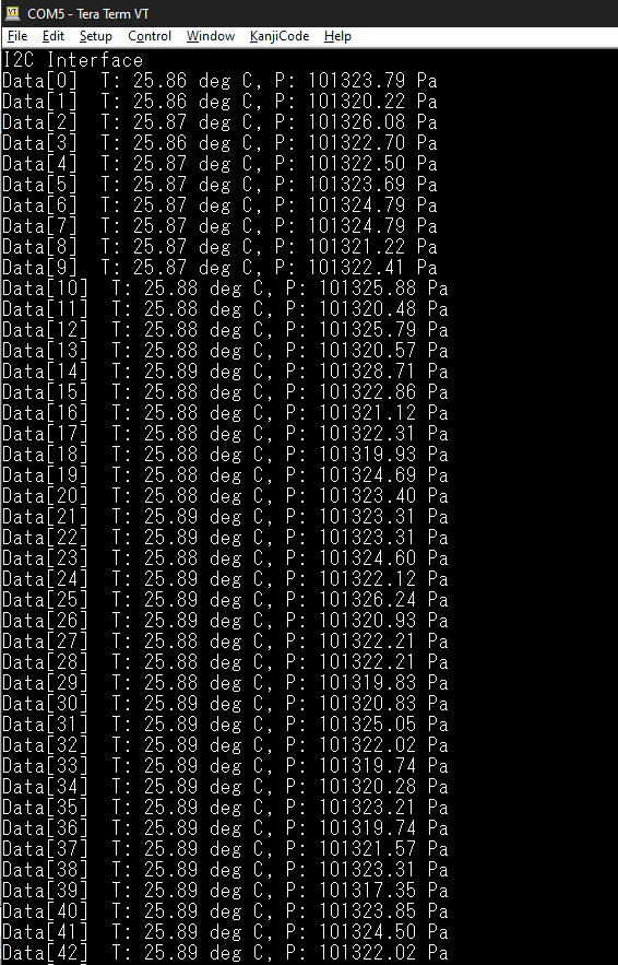

I tested read sensor data example on STM32F401 for your reference. You could see attached reference code and the following test restu, it work well.
BMP3_ReferenceCode.zip
40.33KB
