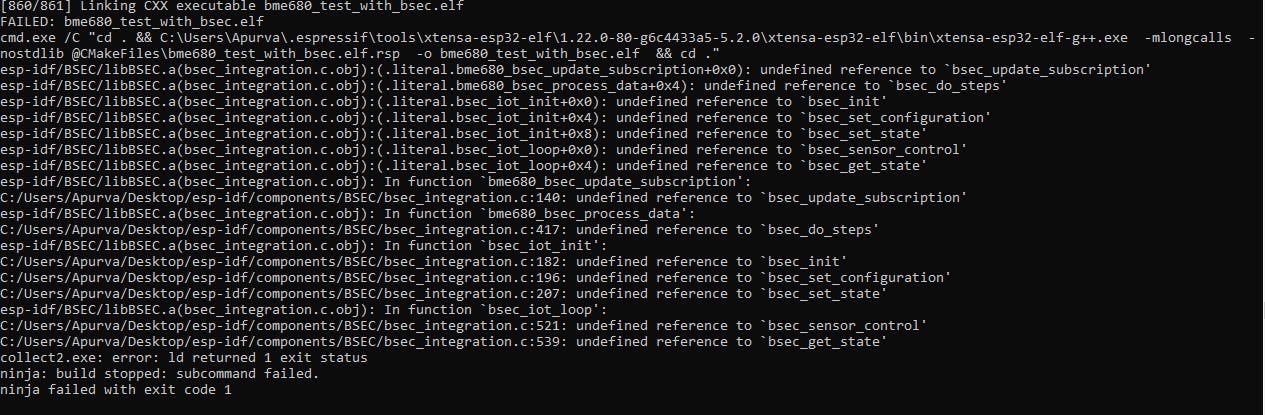

I have not done the 3 steps for linking as stated in the Integration Guide as I do not know where to find the files to which I need to make changes. I am currently getting this error when I build the project:
I would really appreciate any help to get the library running. Thank you!

Hello! I managed to fix the issue. I separated the BME680 files from the BSEC files. My BSEC component structure is as follows:
  • include (folder)
  1. bsec_datatypes.h
  2. bsec_integration.h
  3. bsec_interface.h
  • lib (folder)
  1. libalgobsec.h (normal)
  • bsec_integration.c
  • CMakeLists.txt
  • component.mk
The CMakeLists.txt contains:
CODE: SELECT ALL
set(COMPONENT_SRCS
"bsec_integration.c")
set(COMPONENT_ADD_INCLUDEDIRS include)
set(COMPONENT_REQUIRES "BME680")
register_component()
target_link_libraries(${COMPONENT_TARGET} "-L${CMAKE_CURRENT_LIST_DIR}/lib")
target_link_libraries(${COMPONENT_TARGET} algobsec)
The component.mk contains:
CODE: SELECT ALL
COMPONENT_SRCDIRS := .
COMPONENT_ADD_INCLUDEDIRS := include
LIBS := algobsec
COMPONENT_ADD_LDFLAGS     := -lbt -L $(COMPONENT_PATH)/lib \
                           $(addprefix -l,$(LIBS))
ALL_LIB_FILES := $(patsubst %,$(COMPONENT_PATH)/lib/lib%.a,$(LIBS))
COMPONENT_ADD_LINKER_DEPS := $(ALL_LIB_FILES)
COMPONENT_SUBMODULES += lib
