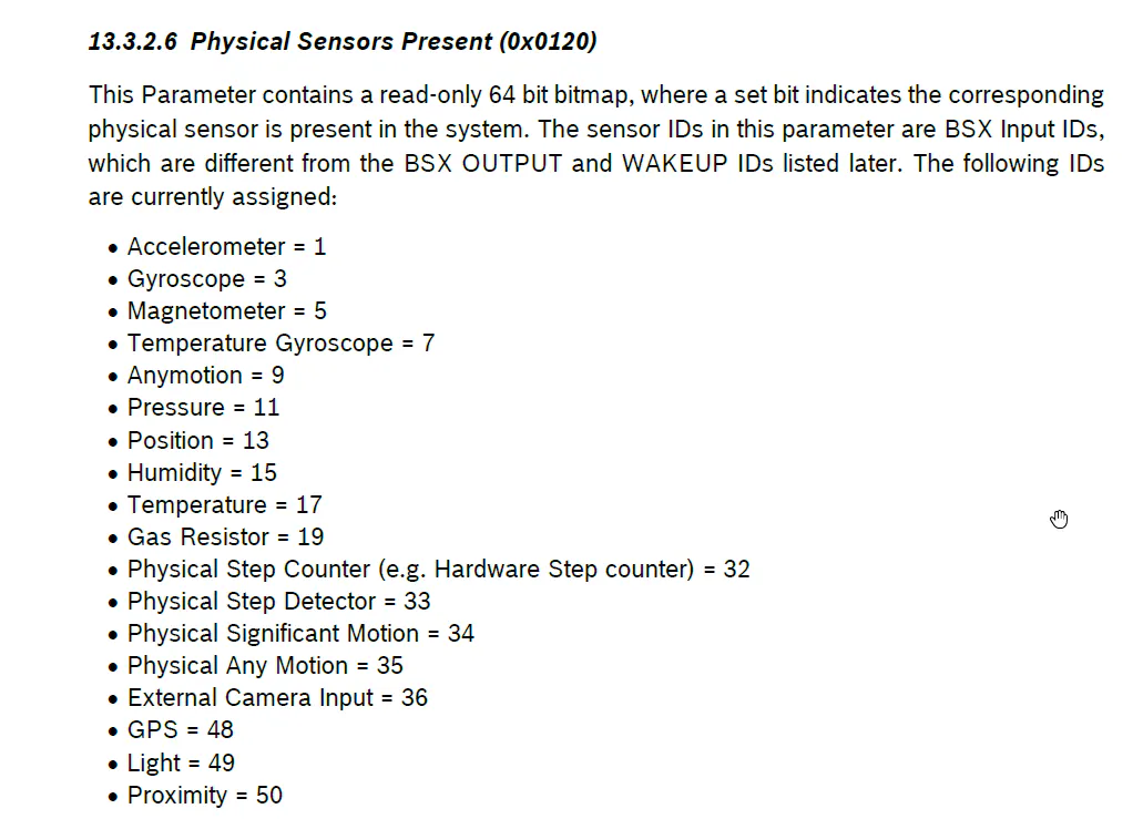

I am calling the function bhy2_perform_self_test() of the C API using the virtual sensor IDs of the Accelerometer, Gyrosscope and Magnetometer. The call succeeds, but the test result returns test_status=9. It seems one has to use the BSX physical sensor IDs?
I found this: https://github.com/BoschSensortec/BSX4-HAL-4.1NoFusion/blob/master/sensord/bsx/inc/bsx_physical_sensor_identifier.h
With these IDs the self test succeed. Are these the correct IDs to use?
