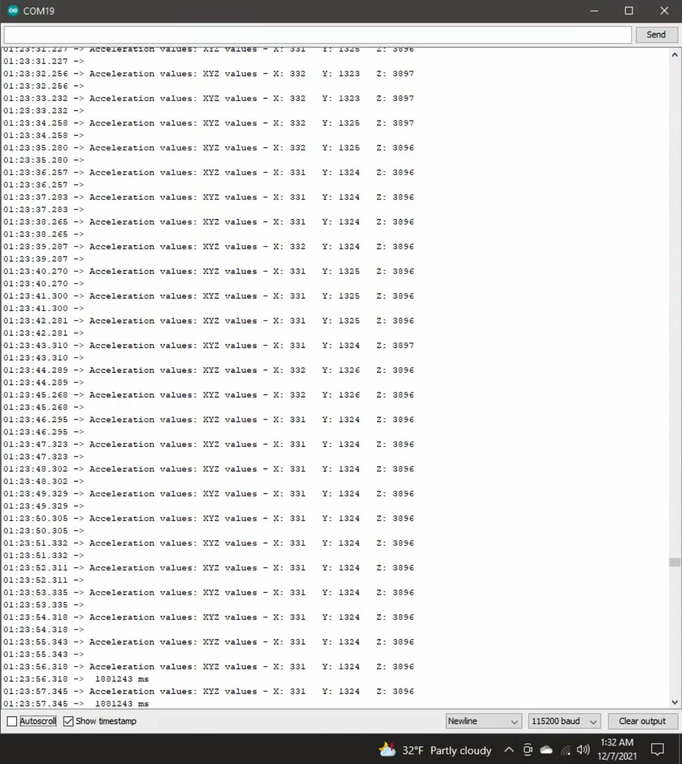

I am trying to get this basic tutorial working for the Nicla and Portenta H7 connected over ESLOV (I2C connection). The bug in the example code is that it only works for a little over half an hour before crashing.
I modified his code for debugging purposes:
arduino-libraries/Arduino_BHY2Host/examples/Accelerometer/Accelerometer_copy.ino:

    String accelReading = accel.toString();
    if(accelReading == lastAccelReading) {
      duplicateReadings++;
      if(duplicateReadings == MAX_DUPLICATE_READINGS) {
        timeToCrash = " " + String(printTime - startTime) + " ms";
        colorToToggle = "red";
    else {
      duplicateReadings = 0;
    Serial.println(String("Acceleration values: ") + String(accelReading) + String(timeToCrash));
    portentaLeds.toggleColor(colorToToggle);
    lastAccelReading = accelReading;

After 1,881,243–2,398,485 ms, the Nicla stops updating…
  • The blue led on Nicla stops flashing, indicating that the BHY2.update(500); line in the loop probably caused an exception.

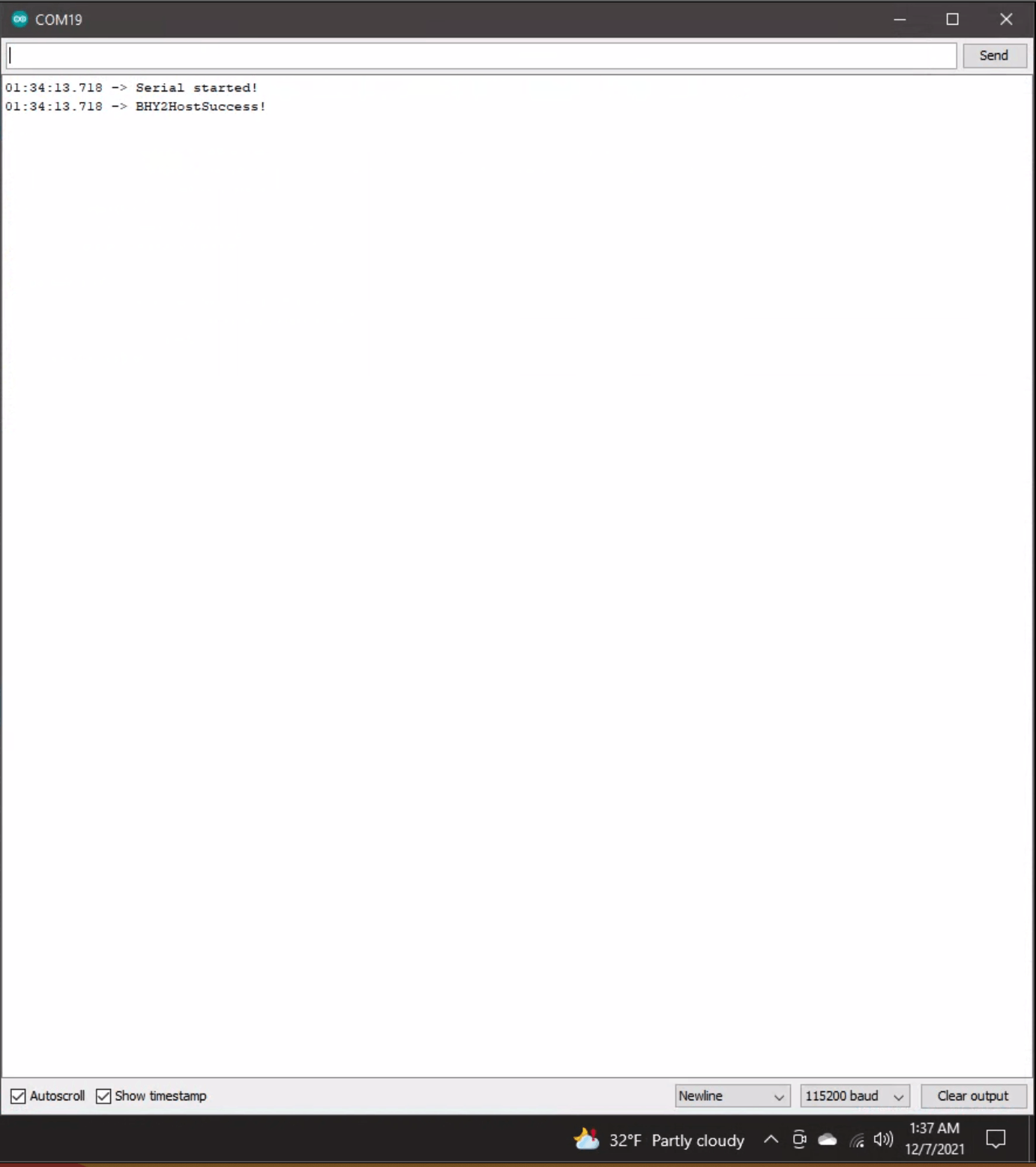

If I reset just the Portenta and relaunch the serial printer, the Portenta halts at the accel.begin(); line in the setup...
