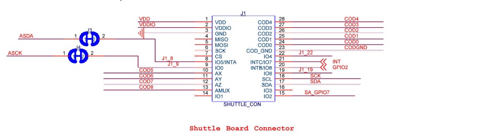

I connected the Shuttle Board to my NUCLEO board like this:
___J1___|___NUCLEO___
   1/2  |    3.3V
    3   |    GND
   17   |    PB7 -> I2C1_SCL
   18   |    PB6 -> I2C1_SDA ​

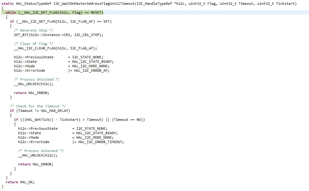

The problem occurs during initialization, specifically within the "bhy_init" function, when attempting to read (BHY_BUS_READ_FUNC) the BHY_I2C_REG_PRODUCT_ID_ADDR register (0x90). It gets stuck in the HAL function (HAL_StatusTypeDef I2C_WaitOnMasterAddressFlagUntilTimeout).
