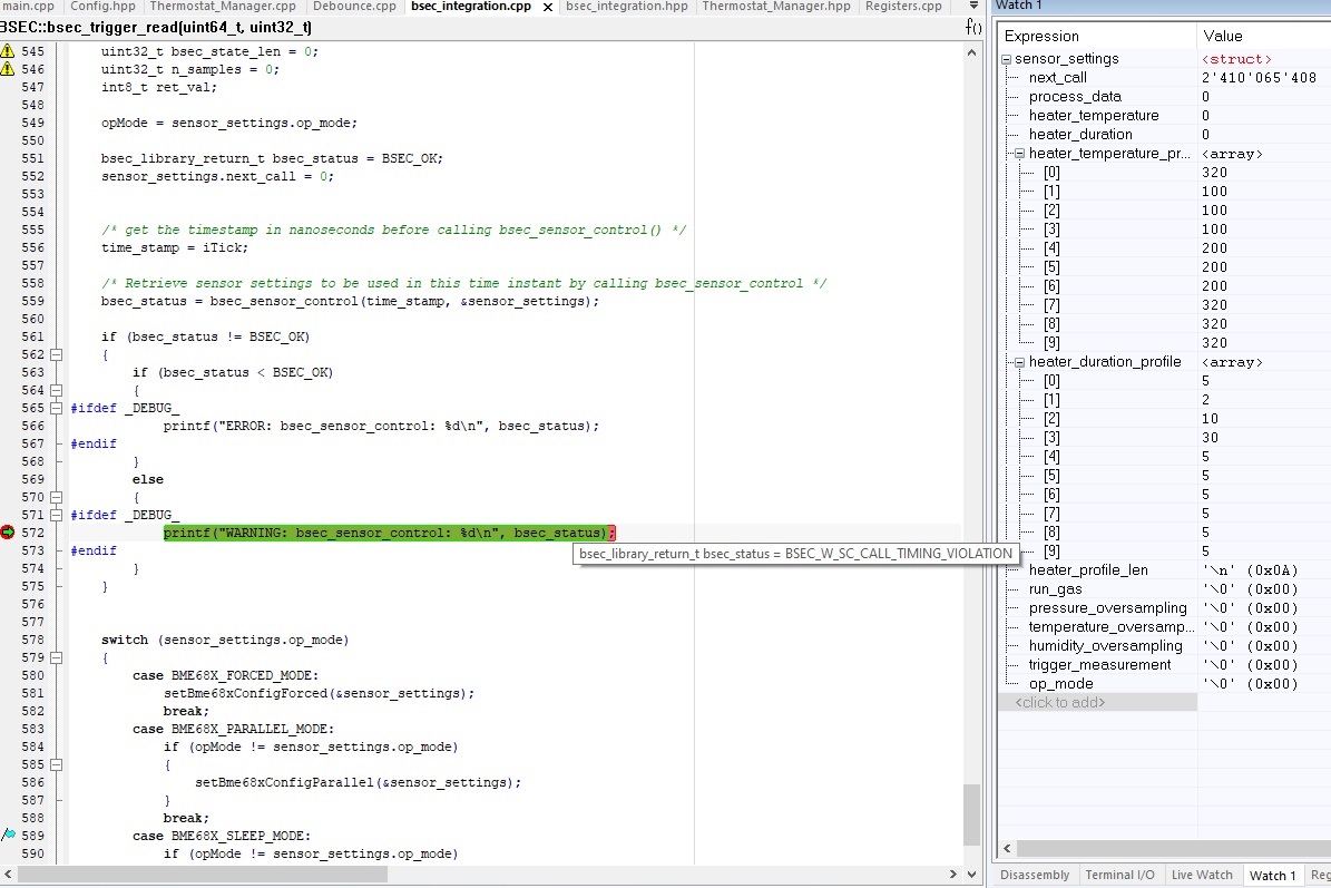

I have this warning in "bsec_sensor_control": BSEC_W_SC_CALL_TIMING_VIOLATION and all output (T, H, P, IAQ) is zero.

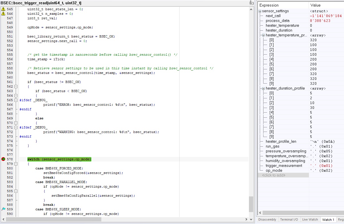

I attach two screens:
- 1: initialization is with BSEC_SAMPLE_RATE_SCAN
- 2: initialization is with BSEC_SAMPLE_RATE_LP

from the BSEC documentation it is stated that the  BSEC_W_SC_CALL_TIMING_VIOLATION error is returned when "The timestamp at which bsec_sensor_control(timestamp) is called differs from the target timestamp which was returned during the previous call in the .next_call struct member by more than 6.25%".
The BSEC_SAMPLE_RATE_SCAN is defined as 0.055556f, so the frequency is 1/18Hz, so basically it samples every 18 seconds while the BSEC_SAMPLE_RATE_LP is  0.33333f and the frequency is 1/3Hz, so the samples are every 3 seconds. I'm afraid that by calling the tick function and saving the value to a variable that is then passed to the bsec_sensor_control() function wastes enough time in case of LP to get you outside of the 6.25% margin, while it keeps you in the margin for the 18 seconds interval.
Try to call the tick function inside bsec_sensor_control and let me know if this was the problem or if i got it wrong.
