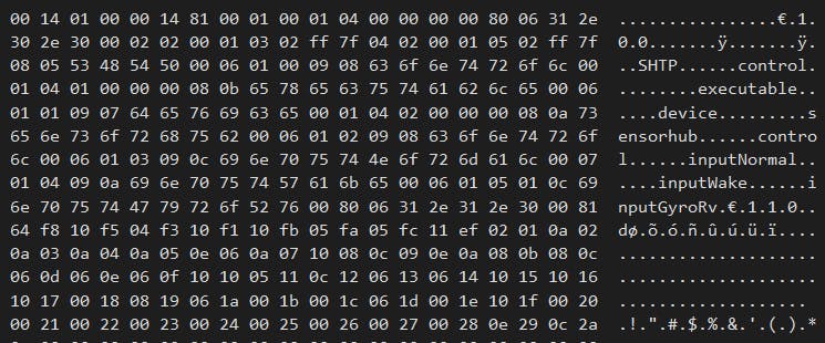

 When I try to receive data, I always get the following packet:
From this reference manual, we can see that it is an advertisement channel of BNO085, It confirms that the communication is established with the controller. I tried soft resetting BNO085 using

When I try to read the Product_ID report using SHTP_REPORT_PRODUCT_ID_REQUEST(0xf9) I do not receive anything of the data rather the same thing as the above image.
