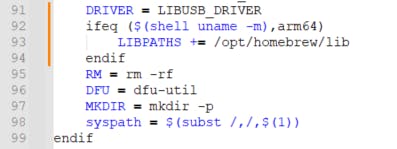

Hi oggyshooy,
Please try the below steps to fix the issue.
1.Install libusb:
libusb will be automatically installed as part of the COINES installation. However, If it’s not installed automatically, you can use Homebrew to install it. brew install libusb After running this command, libusb should be installed on your system.
On Intel Mac: /usr/local/lib
On M1 Mac: /opt/homebrew/lib
2.Add the path in COINES\v2.7.0\coines.mk
