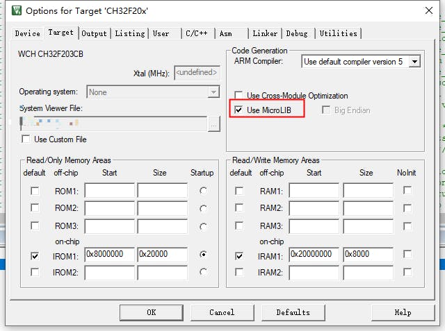

When I call the bsec_update_subscription() function, I receive a warning before enabling MicroLIB,
The warning code is -16, and the description states that the sample rate of the requested output (virtual) sensor passed to bsec_update_subscription() is not correct.
After enabling MicroLIB, I encounter another warning with error code -12. The description indicates that the sample rate of the requested output (virtual) sensor passed to bsec_update_subscription() does not match the sampling rate allowed for that sensor.
