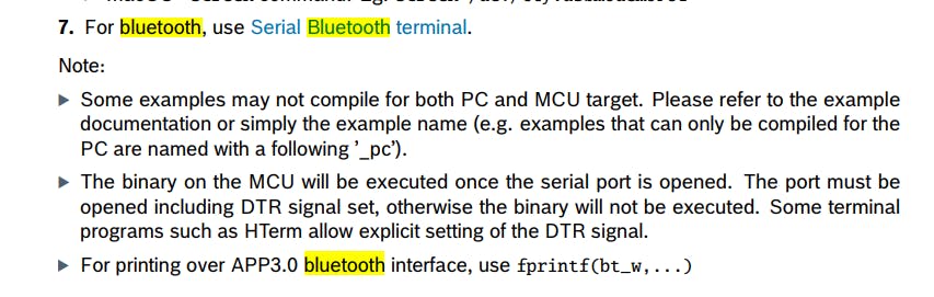

Hello, I have read from BST-DHW-AN013.pdf that COINES can print messages through Bluetooth as seen in section 7 below. But what is bt_w in this case, how do I import it, and is there an example file in COINES?

Thanks for your inquiry.
Please see the attached document about how to log sensor data from APP3.0 to PC via BLE connection.
Thanks.
How to log sensor data into a file on PC via APP3.0 BLE connection v2.pdf
