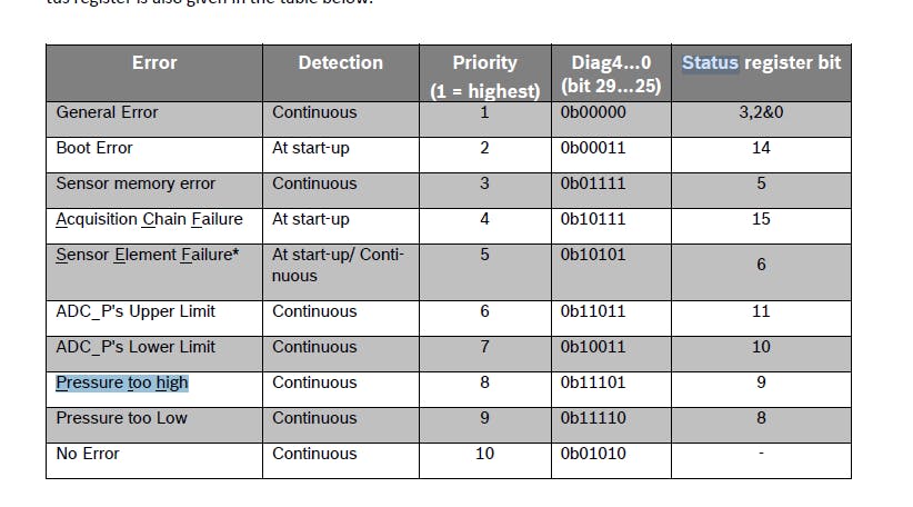

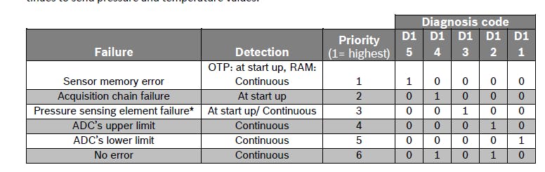

In 32bit response frame 5 bits allocated for diagnostic and also 5 bits used in 16 bits frame for diagnostic.
but in 16 bits frame response Pressure too high and Pressure too LOW error are not reported but reported in 32 bits frame.
So can i used these 2 errors signal for 16 bits error in diagnostic.

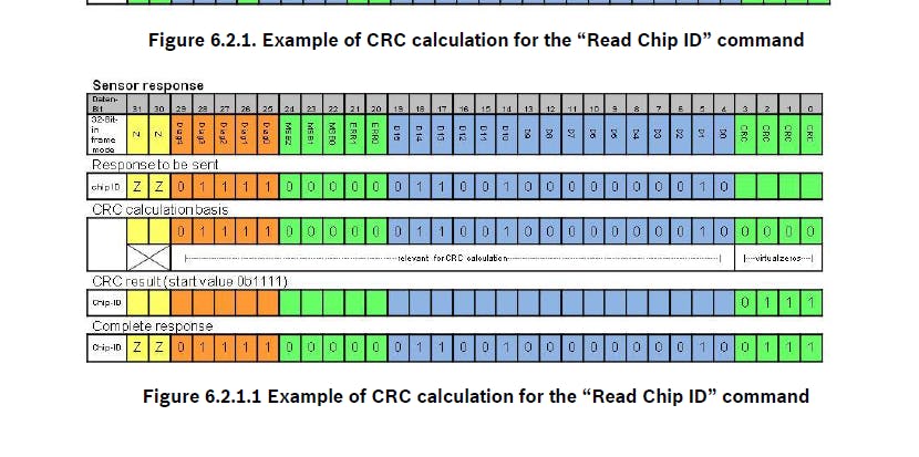

For 32 bits
For 16 bits
Please confirm.
