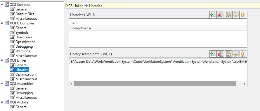

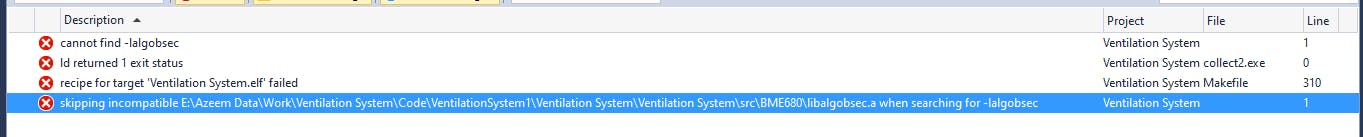

I'm using Libraries --> Add library feature, however upon compiling it says skipping .\libalgobsec.a when seacrching for -lalgobsec (see attachement).
See below screenshot of my linker settings.

After 2 months of experiments, coordination with BOSCH and everything, here is the conclusion.
Pre-compiled library is only compatible with AVR controllers having Boot Memory of 256 Kbytes, and only following 4 controllers make it to list:
  1. ATmega2561
  2. ATmega2564RFR2
  3. ATmega2560
  4. ATmega256RFR2
So if you try to compile libalgobsec.a available in BSEC software for Atmega controllers with any other controller than mentioned above (in my case Atmega644P), it simply doesn't compile.
