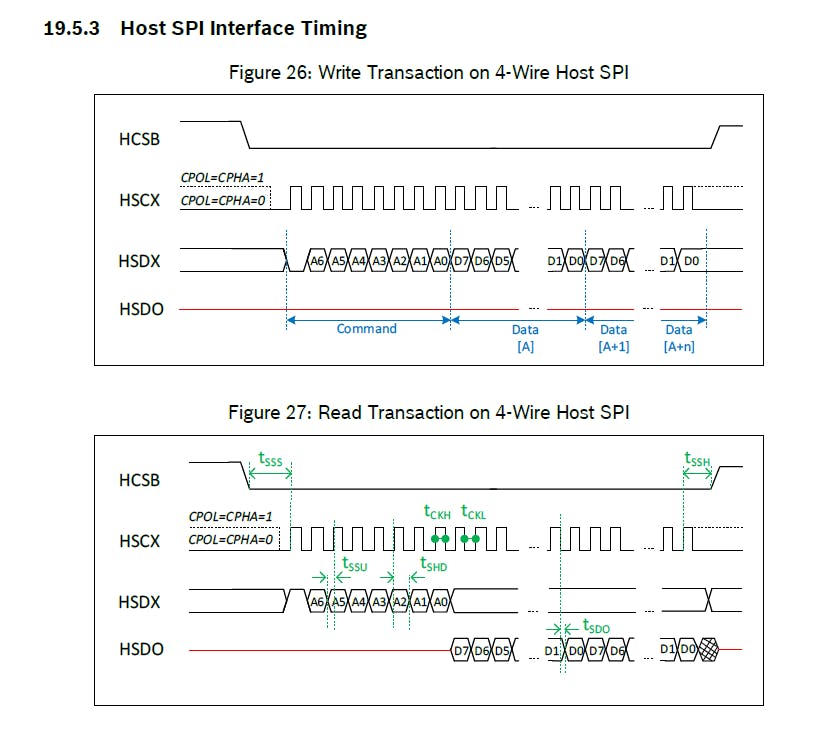

Hi rajesh_s,
Prevous example code run on STM32F401, has no dependency library from coines.
We confirmed previous example can run on STM32, you can check your host software code even you can't run example code on STM32.
For SPI/I2C communictaion timing with host, you can refer chapter 19.5 Timing Characteristics in BHI260AP  data sheet.
