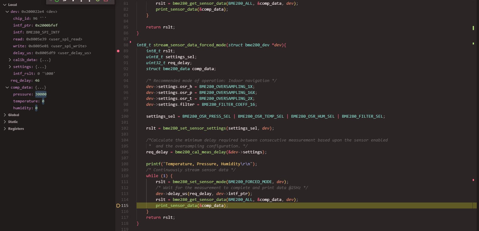

Regards, Is it faulty BME280 or Chinese chip is inadequate defined by chip_id (0x60)? `pressure: 3000,temperature and humidity: 0`
