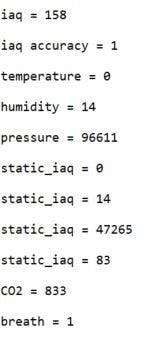

I am trying to integrate BESEC software to interface BME680  with EFR32BG22(Cortex M33).I sucessfully integrate libalgobsec.a file for GCC cortex M33F into my project.The project get  compiled sucessfully without any error.
I have problem with the output data from the BME680.The temperature value remain 0 all the time, and CO2,Iaq and breath values take quiet long time to show-up (initially they all shows 0 values)
My program take reading every 3 sec. I am using simplicity studio IDE and GNU ARM v10.2.1 compiler.
I susppect there is  someting wrong with bsec_init()(initialization in BESEC library) function .It looks like  temperature functionality of BME680 is not getting initialize properly.
I am attaching the snapshot output console:
Please help me to resolve this issue.

I looked into your code, and your sleep fucntion is USTIMER_Delay which could be micro second delay.
However, our sleep function is mili second based.
* @brief System specific implementation of sleep function
* @param[in] t_ms time in milliseconds
* @return none
void sleep(uint32_t t_ms)
// Please insert system specific function sleep or delay for t_ms milliseconds
Could you modify it and run it again ?
