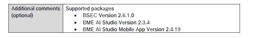

Ensure that the version of BME688 dev kit and BME AI-Studio Mobile App you are using matches correctly.
For example, you can upgrade to the latest BME688 dev kit firmware v2.1.5 using BME AI-Studio Mobile App v2.4.19.
See the dependence in Release Notes_DevKitFW_v2.1.5_Website_Release_29072024.pdf under devkitfw_v2-1-5_website_release package.
Could you check it firstly and give further feedback? Thanks.
