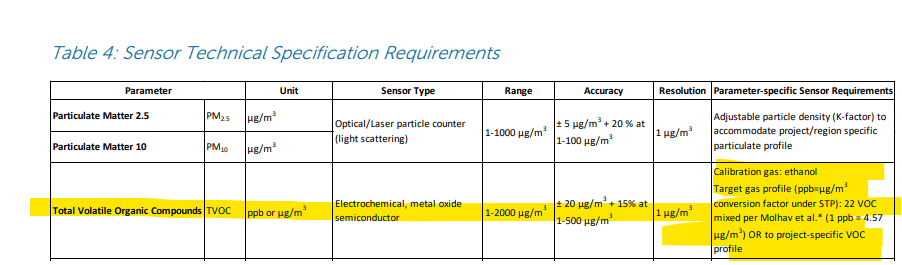

We are using the Bosch BME 680, and we state that the measurement range is 0.10,000 ppb (no accuracy stated)
The below chart is the WELL Building Standard requirement.
We get asked on an almost daily basis if we meet the WELL requirement and we have no answer. Also, get asked for accuracy and can't answer that
Converting 1ppb = 4.57 ug/m3 would fail almost every project.
1- what is the conversion rate from ppb to ug/m3 given the mixture stated in Table 5 of the bosch manual?
2- Given the production tolerance and certified accuracy in Table 5, can we deduce an accuracy range?
Would highly appreciate help on this
Hi mazenjamal,
There is no information from datasheet indicating that measurement range is 0.1 ppb.
The Table5 represents the most important compounds in an exhaled breath of healthy humans, tested with 0.5-15 ppm of b-VOC at 20°C and 50% r.H..
Due to the gas proportion of VOC is changeable, there is not a certain accuracy.
