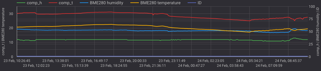

I have three Nicla Sense ME boards, and on all of them the temperature is about 7.5 degrees too high, and the Humidity is about 22% too low. There is little difference between the native temperature reading and the compensated BSEC output. Adjusting the multiplier in the library to the corrected value also has little effect.
I've tried running in standalone mode, and as a shield on an Arduino MKR1010. Same result.
Attached is a plot from 24h, demonstrating a comparison against a BME280.
The code running on the Nicla Sense is below.
Does anyone have any suggestions? And has anyone tested the gas sensor accuracy against a benchmark? I have my doubts, given the strange temperature and humidity readings.
50.95KB
Hi Guys,
The software is ready, you could refer the following steps to run it on you board.
1.download the code from URL https://github.com/bstbud/nicla-sense-me-fw/tree/fea_temp_compensation with the branch fea_temp_compensation;
2.update the BHI260 FW using the sketch: https://github.com/bstbud/nicla-sense-me-fw/tree/fea_temp_compensation/Arduino_BHY2/examples/BHYFirmwareUpdate
3.run Standalone.ino sketch to get the temperature compensated ambient temperature and relative humidity reading from the BSEC sensor (virtual).
Looking forward to get feedback from you.
